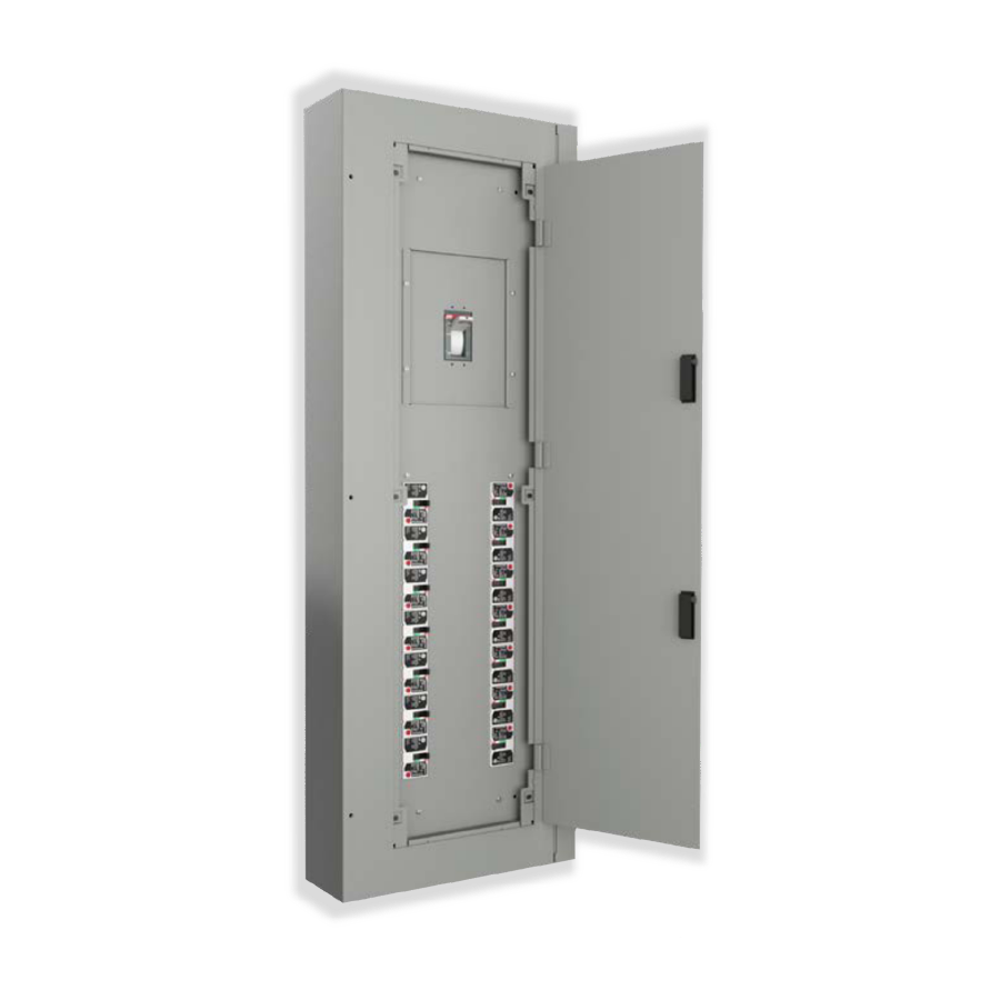

Lighting
Panelboard

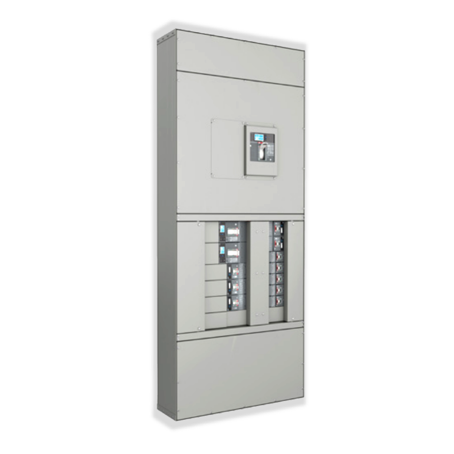

Power
Panelboard

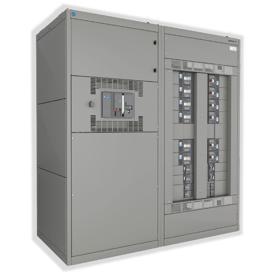

SB
Switchboard

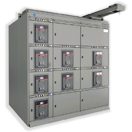

LV
Switchgear

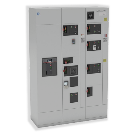

LV Motor
Control Center
Lighting Panelboard
Power Panelboard
SB Switchboard
LV Switchgear
LV Motor Control Center
