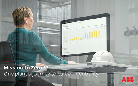

The project also employed ABB’s various digital technologies to make the site a microgrid, using PV solar and ABB’s energy storage system. ABB began the $1.5 million project by gathering data on energy consumption, carbon footprint, and energy cost to set a baseline. Using this starting point, ABB evaluated the impact of an addition of a microgrid and a more energy-efficient building addition to meet established goals.
To get the data required, ABB upgraded the metering equipment in the old building to understand resource usage in real time. In the new plant buildout, new switchgear was installed, which used the ABB Emax 2 breaker produced at the Senatobia facility. With built-in digitalization and technology on the breaker that allows real-time data and condition-based maintenance through the EPiC application, the ABB Emax 2 is critical to a project such as Senatobia’s Mission to Zero factory expansion.
The company purchased an additional three acres of land to build a solar farm, with power entering the new plant footprint immediately adjacent to the energy storage system, which provides approximately two hours of backup power if needed. Smart lighting and a metered, variable speed drive HVAC system further increased facility efficiency, and an on-site DC fast charger encouraged electric vehicle adoption among workers.
Using ABB smart switches, relays, and breakers, operators gain visibility into energy consumption on each line in real time. The data from these smart components support more informed decisions on when a line should run, when to do maintenance, and troubleshooting.
ABB’s in-house systems integrator helped pull the components together with ABB’s Energy and Asset Manager and OPTIMAX® applications from the ABB Ability™ Energy Management Suite. The new facility is now up and running, with an anticipated 20-year payback.
